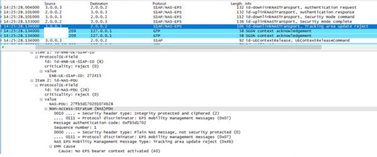

Please tell in different reject scenarios i.e. TAU, Attach, Service Reject send by cell what will be UE behaviour?
Does UE block serving cell if yes for how long.
Any one having simplified explanation for above query highly appreciated.

I checked in specs my query is for just say network send tau reject with cause illegal UE then what UE will do if its stationary and in remote area where no other site coverage there.
Will it try to latch on serving cell again?

Thanks i checked on sharetech earlier where its mentioned UE to wait for 60 s at least before trying plmn search of serving cell.
I seen ue within 10s reading mib, sib1 of cell from where its get rejected.
