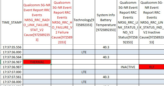

Thermal Fail Qualcomm cause for RLF.
So even at 40 Thermal RLF occurs.

Do you have an exact value of bat. temp when NR is cut and when NR is added back due to temp?
I see in logs that as soon as bat temp is above 42 the NR is released and when bat temp drops below 41 is added back.
But do you know exact values from code line?
When temp crosses 43 degree, UE send A2 event (-140 dBm default) and NR leg is released by gNB.

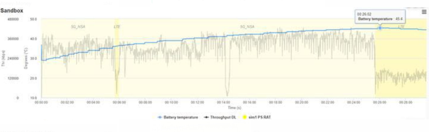

Plenty of handsets have the same behaviour after 20-25 min 5G uses switching to 4G.

You doo 4-5 ookla tests.
And that’s it : 5G is released.
