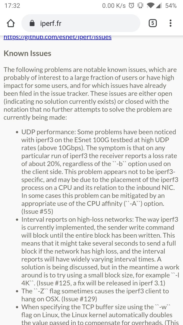

I had some issues with iperf2 and
There are some known issue with iperf as well…

Try iperf3.
I will try this… Do you have iperf3 commands?

It’s the same as iperf2.
It would be: iperf3 -c 192.168.25.100 -p 50001
You can try to add -P 5
It will do x5 tcp streams in parallel.
