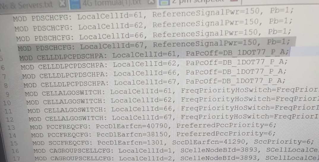

I have a script that was executed on a specific site to balance traffic between two TDD carriers.
However, there is a gap between the two carriers. I selected specific cells on particular sectors to conduct a test.
4G LTE RS RE Power boosting calculator
The marked commands failed. :point_up_2:
Can anyone advise what factors to consider or what to look for in troubleshooting this issue?
Try using a reference signal value of 120 instead of 150.
OK, I will try it.
But regarding the second marked command, any ideas? It seems to be related to the first command in the script.
You can try changing it to -3.

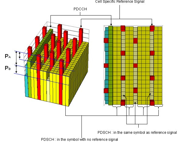

It’s possible that your RRU doesn’t have sufficient power.
Try using the calculator based on your network configuration.
There is one excellent Excel tool.
