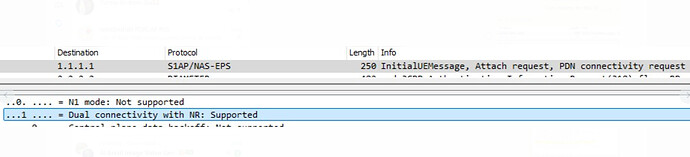

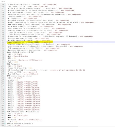

First, check in the Attach Request or TAU Request to see if DCNR (Dual Connectivity with NR) is supported :

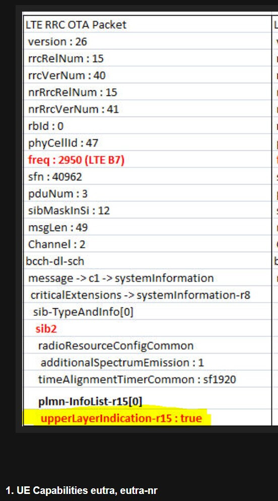

Also, check the SIB2 message in LTE to verify if the Upper Layer Indicator (ULI) is set to true :

This information comes from a TAU Request or Attach Request sent by the UE in the Uplink.

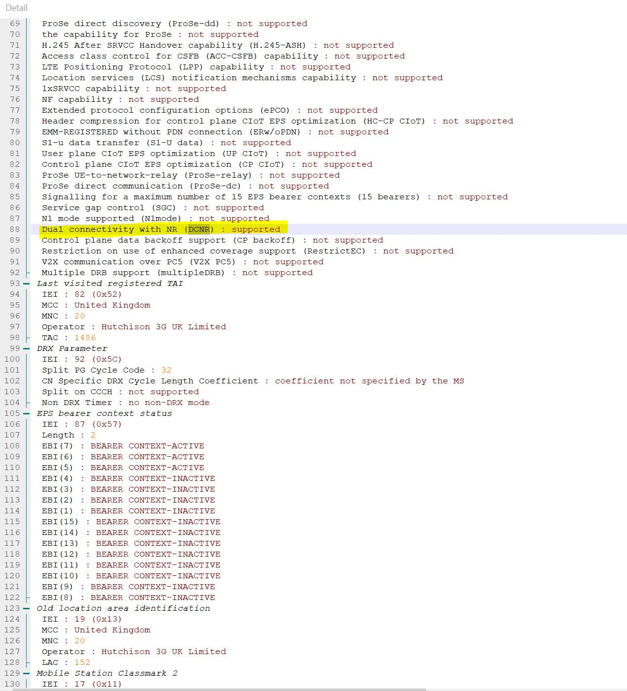

Thank you, I saw the message. What could be the reason the iPhone isn’t connecting to NR?
After this, the network does not request the NR information from the iPhone.
Could you please share the content of the Attach Accept message?
I am specifically looking for this Information Element (IE):
