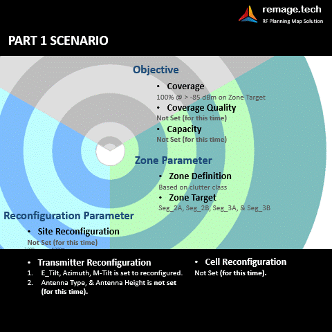

Setting ACP Parameter
  1. Objective.
    a. 100% Target Coverage RSRP >= 85 dBm in Zone Target (specific target).
    b. Other objectives are disable (we will discuss this part later on, step by step).
  2. Zone Parameter.
    a. Defined Zone target, at this part we set Seg_2A, Seg_2B, Seg,3A, & Seg_3B from clutter map as our target that must get 100% RSRP >= 85 dBm.
    b. Other area is allowed to degrade.
  3. Reconfiguration Parameter.
    a. Set Transmitter Paratemer allowed to change (e-tilt, m-tilt, & azimuth).
    b. Other Parameter (Site Configuration, Cell Configuration, Antenna Type) are not allowed to change.

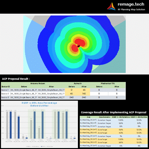

Result Implementation of ACP Parameter Proposal
a. Seg_2A, Coverage RSRP >= 85 dBm is improved, from 69% to 100%.
b. Seg_2B, Coverage RSRP >= 85 dBm is improved, from 40% to 100%.
c. Seg_3A, Coverage RSRP >= 85 dBm is maintained, from 100% to 100%.
d. Seg_3B, Coverage RSRP >= 85 dBm is improved, from 96% to 100%.
e. while other are which is not target is allowed to degrade.
Summary
PART 1, ACP exercise show that ACP has ability to do coverage (RSRP) optimization, if we input proper Objective, Zone Parameter, & Reconfiguration Parameter.
