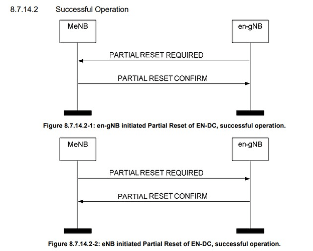

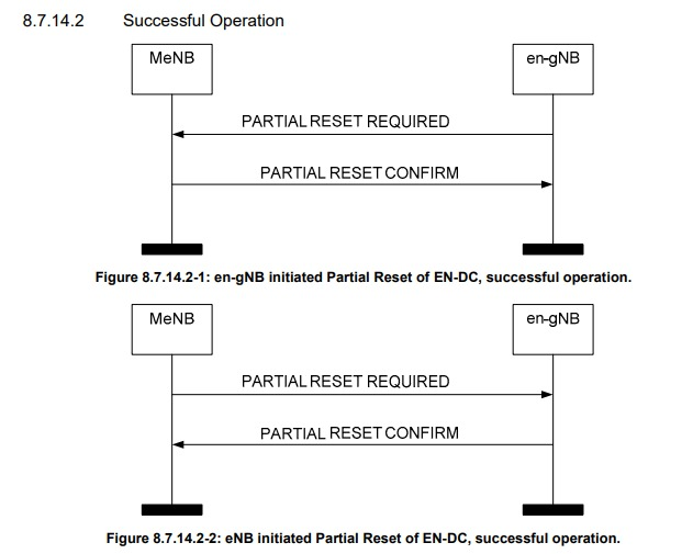

This is from 3gpp:
Both meNB or gNB can trigger it, but in what conditions it might be triggering, no information…
