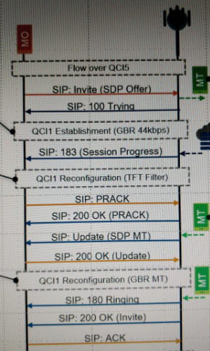

Not really, vast majority of the operators I’ve worked at work with preconditions, QCI1 comes right after the Trying/Session Progress.
It will take a loooong time between QCI1 be established and the call being connected (200 OK for INVITE).
Something like this for MO:
Early media is also a key factor for early establishment of QCI 1.
That’s why I asked about call setup impact, you may screw up everything that comes after QCI1 establishment, resulting in either lost and/or delayed SIP messages.
