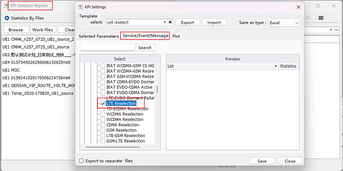

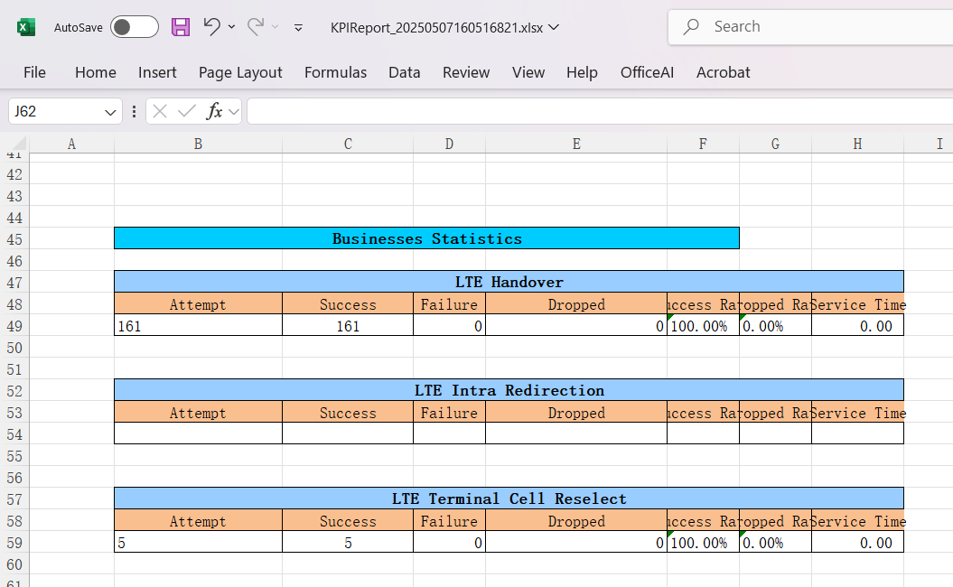

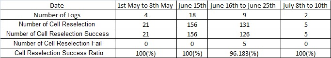

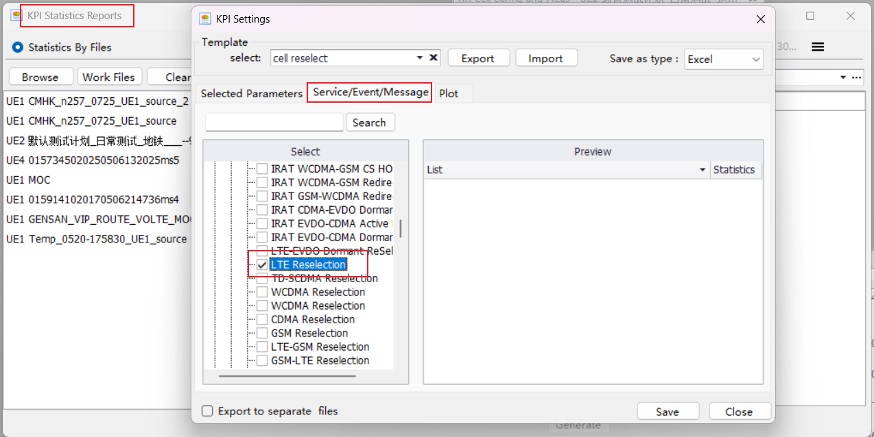

He shared this photo but don’t know how he calculated?
Earlier there were information elements (IEs) in TD postprocessing tools.
Not sure whether they have added these events in the TD events or L3 events though.
I haven’t used the pp tool from long time.
If anyone is using the PP tool then it will be easy to explore.
You may simply get the cell reselection KPIs from customized report
