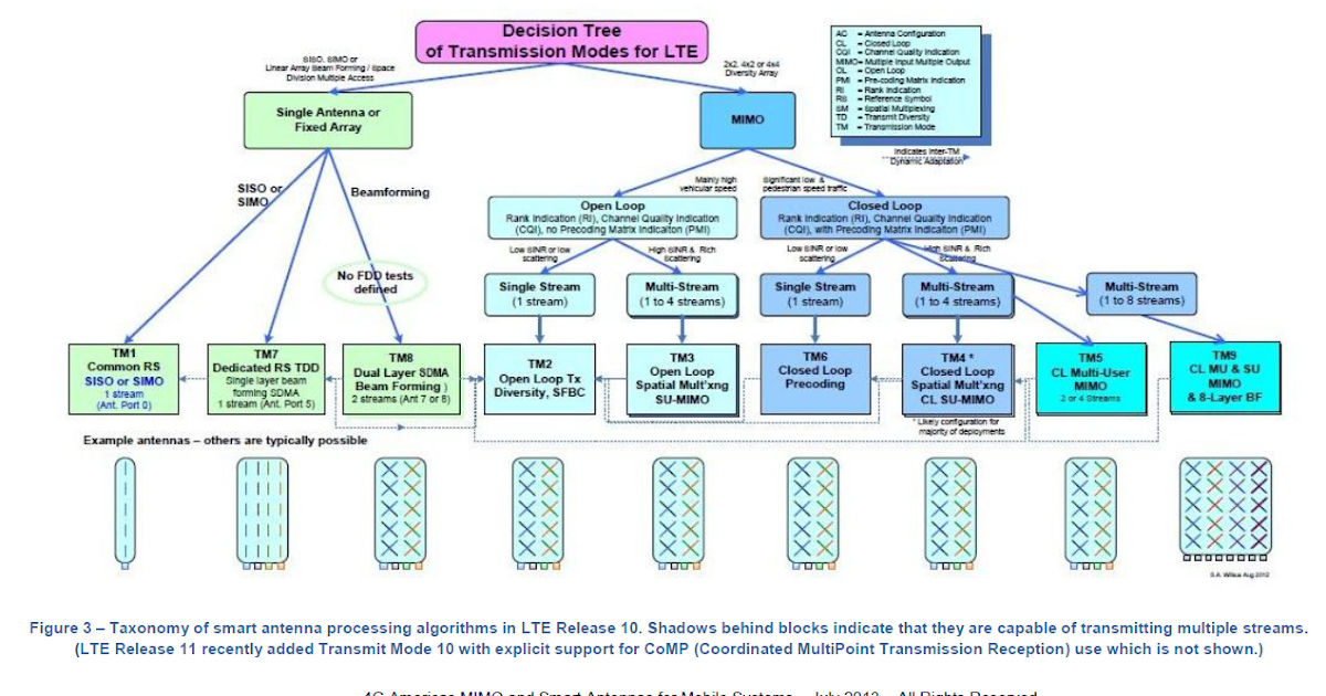

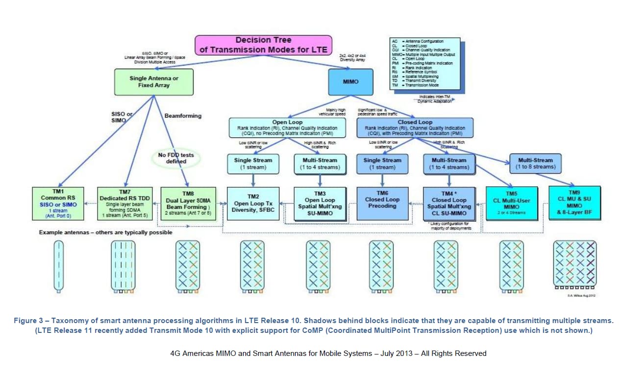

Yes. Look at the decision tree in the link I sent. TM9 is close loop MU MIMO.
