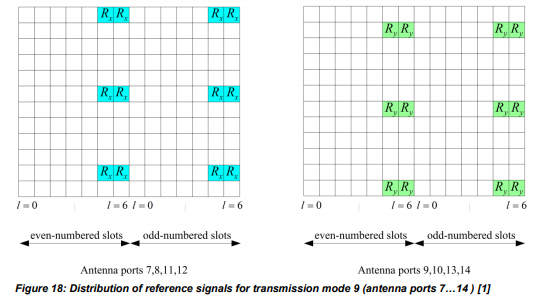

TM 10
In TM10 mode there is Up to eight layers can be used, so up to eight physical transmit antennas are needed, this leads to up to 8x8 MIMO configurations.
The number of used layers may be defined dynamically. The virtual antenna ports 7…14 are used.
TM10 uses the same reference signals like TM9, see below:
The main difference to TM9 is the used DCI format (2D). With TM10 Coordinated Multi Point Transmission (CoMP) is supported.
