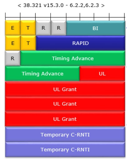

This is RAR:
The mobile will calculate Timing Advance (TA) using the following formula:
Timing offset for the UE is the time delta between the borders of DL subframes and borders of UL subframes from UE perspective and it is typically negative. The value is sent to the UE from eNodeB as Timing Advance value using TA command
During CBRA, an absolute value is sent by eNB is RAR based on preamble delay in msg1.
To maintain UL synchronization, eNB needs to regularly send other TA commands with relative TA value with respect with previous TA
If UE doesn’t get TA until TAtimer expiry, UE has to intiate another CBRA
