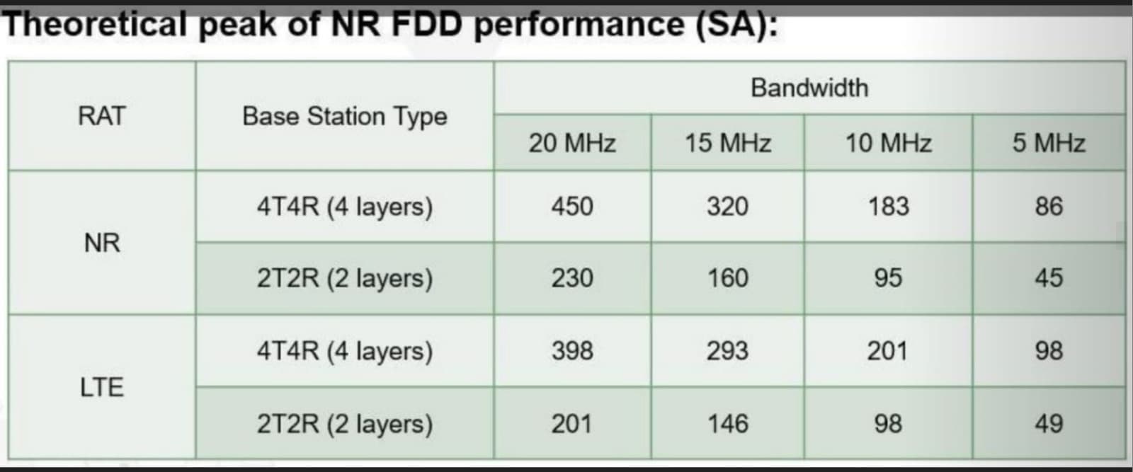

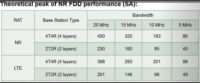

Take a look at this picture:
So, NR offers some improvements, but the advantage is not significant.
Higher throughput in NR is primarily achieved through increased bandwidth.
If LTE and NR cells operate with the same bandwidth, there is no significant improvement in NR compared to LTE.

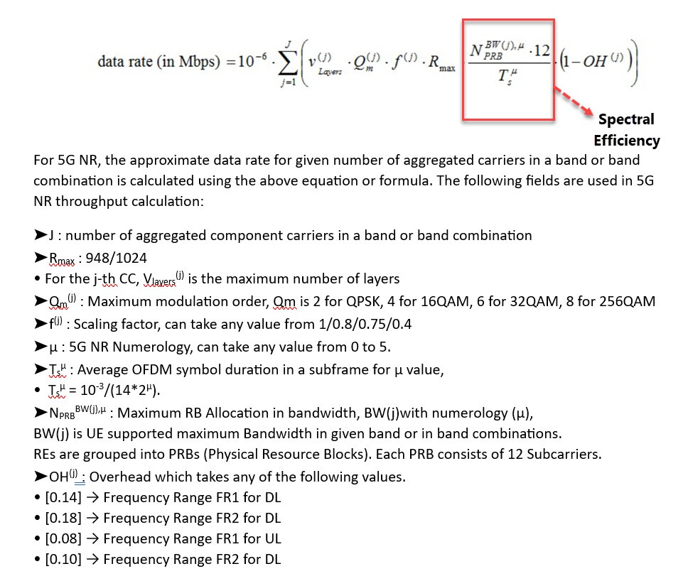

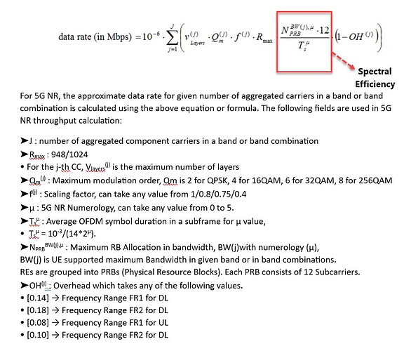

I meant that the gain in 5G comes from improved spectral efficiency.
Here is the 3GPP calculation that addresses the same concept.
This is a complex topic that requires careful consideration of several factors, including:
Key Considerations:
  1. Massive MIMO or Non-Massive MIMO
  • With Massive MIMO: Additional overheads impact efficiency.
  • Without Massive MIMO: Different performance characteristics.
  1. Overhead Contributions (With Massive MIMO)
  • SSB Overhead:
    • 4 SSB → 0.5%
    • 7 SSB → 1.05%
  • Control Channel & Reference Signal Overheads:
    • PDCCH + DMRS → 7.1%
    • PDSCH + DMRS → 7.1% to 14.2% (depends on Additional Position DMRS for MIMO).
  1. TDD vs. FDD Comparisons
  • Differences in guard period calculations impact efficiency.
  • Performance depends on scheduling and interference management.
  1. Slot Structure Selection
  • 10:2:2 (DL: 73%)
  • 6:6:2 (DL: 70%)
  • Different structures influence spectral efficiency.
  1. Subcarrier Spacing Impact
  • 15 kHz vs. 30 kHz: Guard band calculations differ (as specified in 3GPP 38.101-1).
  • Selection depends on deployment scenario and network optimization.
  1. Modulation Scheme (256 QAM)
  • Consider the maximum MCS value allocated for realistic throughput estimation.
Final Assessment:
  • If all factors are considered, NR has an advantage over legacy systems due to better guard band efficiency (1-3% gain).
  • However, the correct requirements and assumptions must be defined before drawing conclusions.
:backhand_index_pointing_right: Recommendation: Ensure a well-defined requirement before raising this question.
