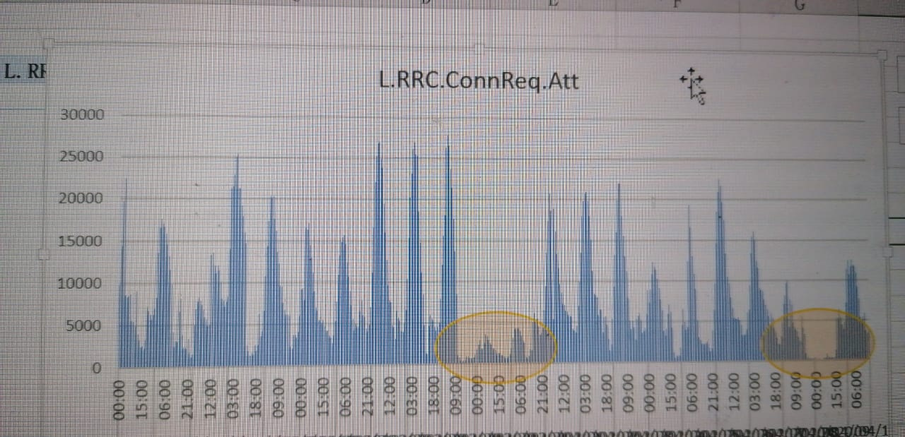

Any network is facing huge reduction of rrc and erab attempts?
There is a TCP sync flood attack going on all over the world, but very low throughput attack.
Ue receving few DL packets every few seconds and UE cannot go to idle.
Here, increasing.
As well as payloads.
Since the #StayAtHome
We face the issue in FWA LTE network and already mitigate the attack by identifying source ips.
But it’s not throughput reduction, you will see 70% Rrc attempts and erab attempts reduction.
Due to UE is always in Rrc-Connected mode.

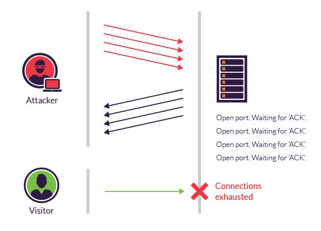

What is a SYN flood attack
TCP SYN flood (a.k.a. SYN flood) is a type of Distributed Denial of Service (DDoS) attack that exploits part of the normal TCP three-way handshake to consume resources on the targeted server and render it unresponsive.
Essentially, with SYN flood DDoS, the offender sends TCP connection requests faster than the targeted machine can process them, causing network saturation.
Attack description
When a client and server establish a normal TCP “three-way handshake,” the exchange looks like this:
- Client requests connection by sending SYN (synchronize) message to the server.
- Server acknowledges by sending SYN-ACK (synchronize-acknowledge) message back to the client.
- Client responds with an ACK (acknowledge) message, and the connection is established.
In a SYN flood attack, the attacker sends repeated SYN packets to every port on the targeted server, often using a fake IP address. The server, unaware of the attack, receives multiple, apparently legitimate requests to establish communication. It responds to each attempt with a SYN-ACK packet from each open port.
The malicious client either does not send the expected ACK, or—if the IP address is spoofed—never receives the SYN-ACK in the first place. Either way, the server under attack will wait for acknowledgement of its SYN-ACK packet for some time.
Progression of a SYN flood.
During this time, the server cannot close down the connection by sending an RST packet, and the connection stays open. Before the connection can time out, another SYN packet will arrive. This leaves an increasingly large number of connections half-open – and indeed SYN flood attacks are also referred to as “half-open” attacks. Eventually, as the server’s connection overflow tables fill, service to legitimate clients will be denied, and the server may even malfunction or crash.
While the “classic” SYN flood described above tries to exhaust network ports, SYN packets can also be used in DDoS attacks that try to clog your pipes with fake packets to achieve network saturation. The type of packet is not important. Still, SYN packets are often used because they are the least likely to be rejected by default.

Due to increased user activity…user will not release RRC and ERAB that frequently and attempts will reduce…we have observed it in our network.
If it’s Huawei, you can check active user counter… Is there a sudden jump in active user count?

But this reduction happen gradually right?
But our case is sudden.
Any changes done related to RRC connection state timer?
Yes it is and small packet count also slight increment.
No, UE inactivity timer is 20 Seconds since long time.
