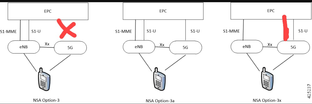

Guys, i have a question.
When switch data split from LTE to gNB or from option 3 to 3x, is this action need alignment with the EPC Core as as mark in red?
S1-U need to setup when switch from 3 to 3x and need to be removed when switch from 3x to 3?
You can’t use option 3x and 3 simultaneously.
You need to choose one configuration.
Most used is 3x and data split is managed by the gNB using specific threshold.
Ok dear.
But I mean what is role of red mark connection here?
Should this interface between EPC and gNB setup when use 3x and removed when use 3 from Core side?
