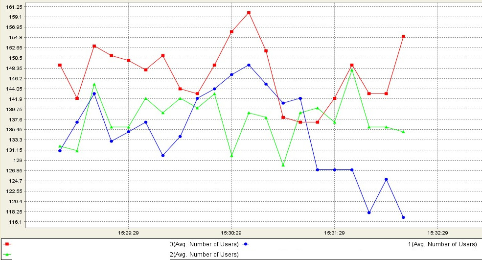

User in site, in blue color sector with problems.

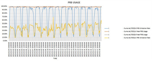

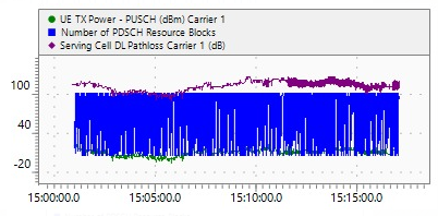

PRB Usage:

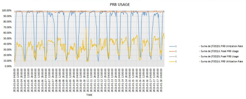

In Walk Test, PRB 100%:

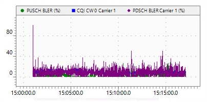

BLER:

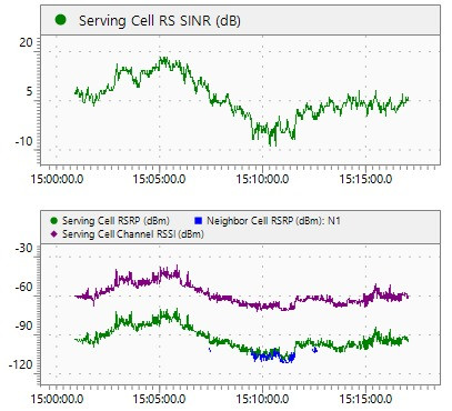

SINR and RSRP:

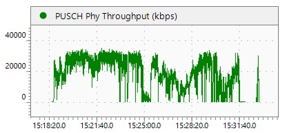

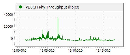

Throughput DL always down:

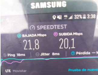

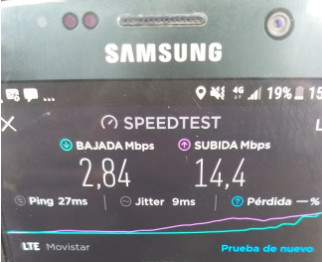

Throughput FTP agree with Speed Test.
Throughput UL is agree that FTP UL:

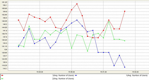

You have 150 avg user per cell, thats a lot!
Is that active connected users?
RRC connected users.
Active users is less.
This is congestion problem then.
Your SINR is bad even in good RSRP but that is possibly due to too many users.
20 MHz with 2x2 MIMO and 64QAM has max throughput of 150 Mbps.
150 users active is avg 1 Mbps per user.
You may want to reduce your cell load.
Lower inactivity timer and see if that helps.
