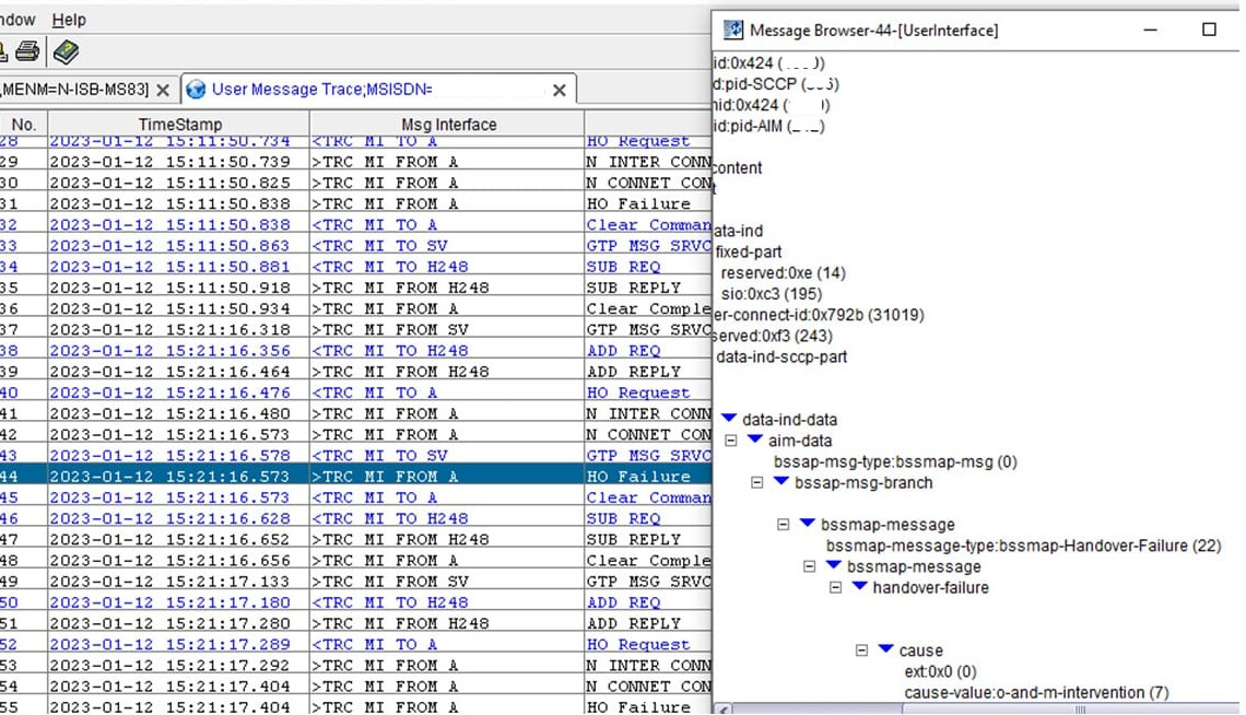

SRVCC failure: bssmap-Handover-Failure caused by o-and-m-intervention
What could be below cause for SRVCC failure?
What do we need to check?

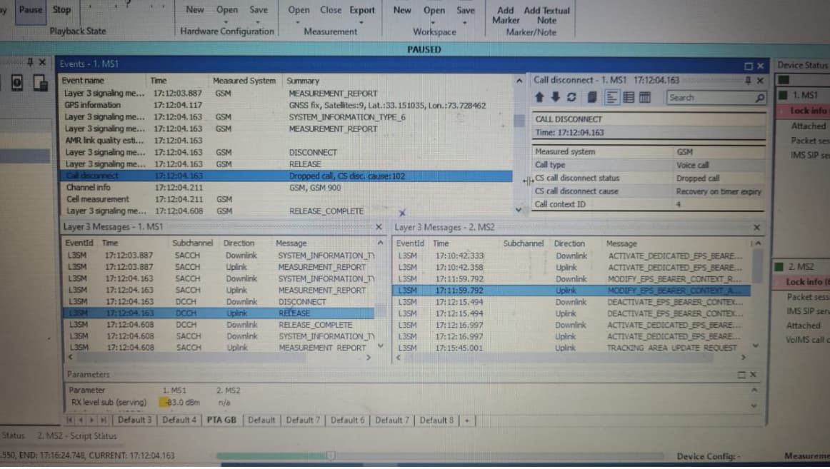

From DT, logs recovery on timer expiry failure shown:

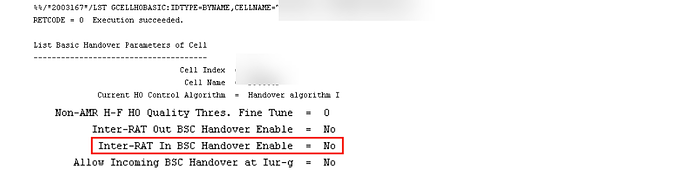

check if incoming IRAT Switch is on for GSM cell

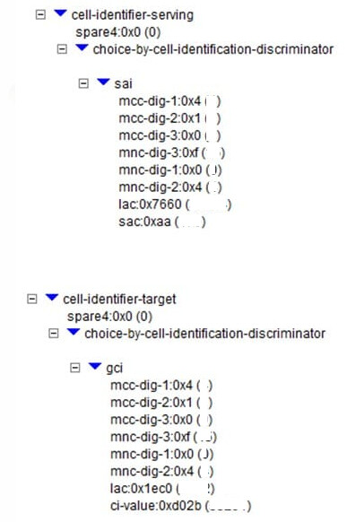

other than that check CGI as well(At core side in MSC and RAN side)
Check SRVCCHOEN in GCELLHOBASIC MO on BSC, it should be set to yes for SRVCC to GSM Cell.
Thanks mohammad. Issue resolve after enabling this switch
