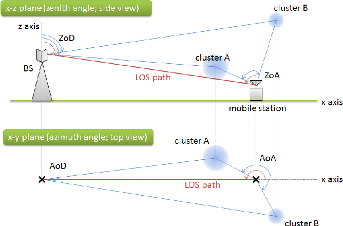

1)For DL angle-based they propose using the AoD/ZoD from the gNB → triangulation.
Beam sweeping using CSI-RS at the gNB side with the UE taking RSRP measurements and then reporting the vector of measurements.
Compare the RSRP vector to fingerprints of pre-stored angles and estimate AoD/ZoD.
2)For UL angle-based they propose using the AoA/ZoA at the gNB → triangulation.
Use SRS and make angle estimate based on received signal.
