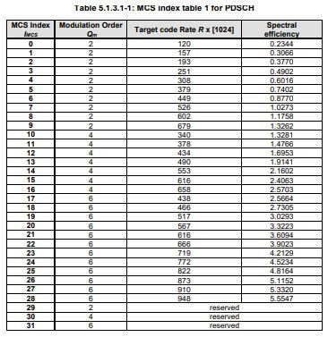

:slightly_smiling_face: Did you know that 3GPP TS 38.214 Spectral Efficiency column in Table 5.1.3.1-1, actually refers to the Bearer efficiency??? Indeed following the row for MCS 25, that translates into bearer efficiency = (Modulation order) x (Target Code Rate) = 6 x (822/1024) = 4.8164 without mentioning bandwidth
:light_bulb: well…to convert from that point to real 5G NR resource grid spectral efficiency, for a given SCS, we need to use the convertion formula:
BE (bits/symbol) = SE x SCS bandwidth (Hz) / (symbols/slot) x (slots/sec) = (SE x 120000) (bits/sec) / (14 x 8000) (symbols/sec) = SE x 15/14 (bits/symbol)
Or
SE = BE x (14/15)
