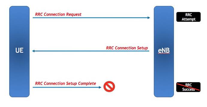

RRC No Reply Failures are among the top RRC failures in most networks, primarily caused by weak uplink signals and users in poor radio conditions or overshooting cells.
To better understand this, consider the following:
  • The RRC Connection Request message is usually around 7 bytes in size.
  • The RRC Connection Setup Complete message, however, can include the entire NAS information (e.g., TAU or Attach Request) and varies in size, ranging from as small as 8 bytes to over 100 bytes.
Now, imagine a UE at the cell edge with limited power:
  1. When the UE sends the RRC Connection Request (7 bytes), it requires only a small number of resource blocks (RBs), resulting in higher power per carrier.
  2. However, when sending the RRC Connection Setup Complete (potentially 100 bytes), it needs a larger number of RBs, even with fragmentation. This reduces the average power per carrier.
  3. As a result, the eNB might fail to decode the message due to insufficient signal quality.
This explains why poor uplink conditions can significantly contribute to RRC No Reply Failures.
You can improve it by increasing T300 timer, by coverage Optimization, Overshooting elimination, Coverage Enhancement & Power Control
