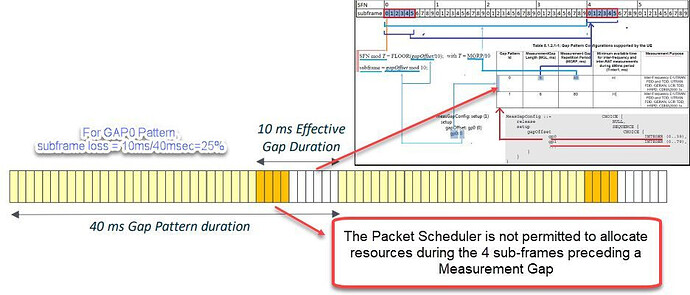

5G Secondary node addition means UE that camped on LTE will enter MR GAP configured via RRC_Connection_Reconfiguartion to measure 5G-NR Cell and triggering B1 event as shown below.

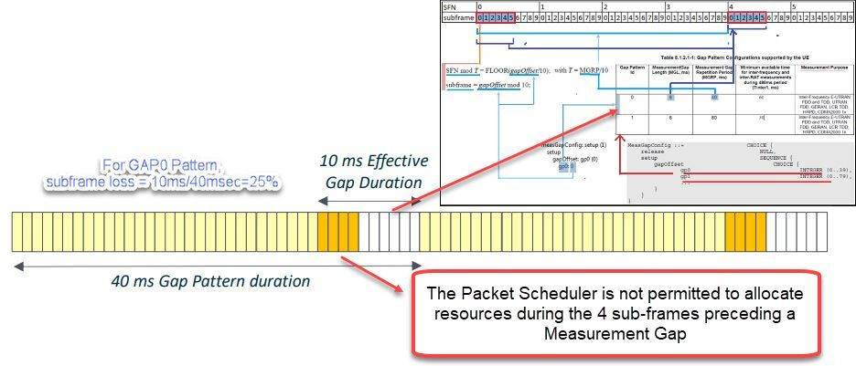

Problem here is that for UEs that did not locate in 5G-NR coverage will continuous config LTE GAP pattern forever as not suitable 5G NR coverage can get to report event B1. This behavior will degrade LTE user throughput around 25% as shown below.
Note that for UE that support 5G inter-system measurements without Measurement Gaps have no effect on LTE throughput degradation. But not all UEs may support this , many UEs would be unable to complete 5G measurements if Measurement Gaps are disabled.
