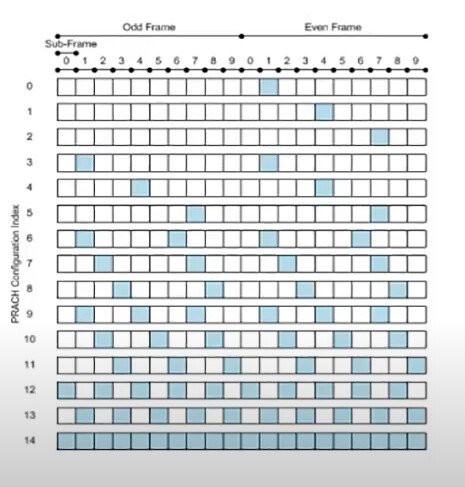

With PRACHConfiguration Index = 3, the preamble can be only sent in odd and even frame SFN subframe number 1. Refer to below pic for more understanding.
Please check your configuration onAccess side also related to PRACH. eNodeB calculates PUSCH resources needed for UE uplink transfer based on the preamble sequence. Maybe some config mismatch is not allowing enodeb to allocate PUSCH resources properly. which may be working properly for PRACHConfiguration Index = 35.
