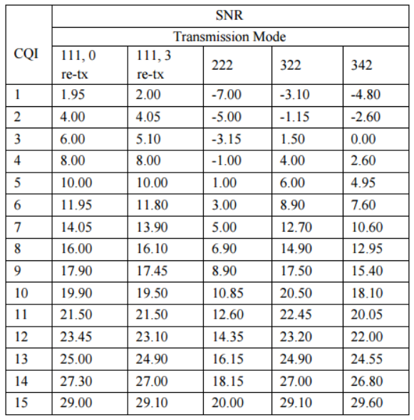

How to Choose SINR Target for Planning for LTE. and How about RSRP target.

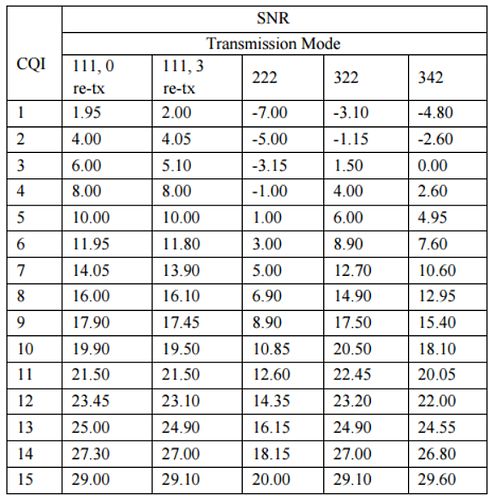

hi , i am not expert but here is an idea :sinr is related to quality of the channel and throughput ,so an easy way is to put a target of the quality for the users for example the 20% of the users are acceptable quality, 60% good 20% excellent ,( to make life easy just use the cqi number from 1 to 15 ) after that there is mapping between cqi and sinr based on the transmission mode as in the table in the below link :
https://www.sharetechnote.com/html/Handbook_LTE_CQI.html
so for example for the cell edge user when using tx mode 222 the sinr -7db would be acceptable
for rsrp i found this figue i am not sure about it ,but it seems good:

Thank you for Reply, can we take SINR >12 as a target for Planning, is it possible in real network. is yes than how ?

dear please notice that i changed the figure ,you can see the table in the link its more accurate
Greater than 20 db is the best sinr . But for planning we can take 12 db.
