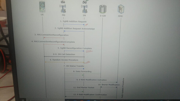

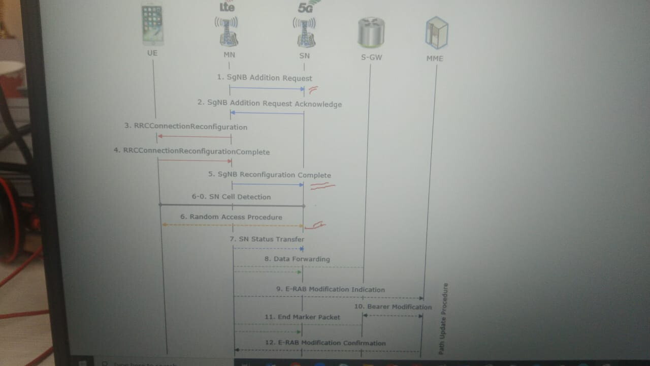

As per this, RACH is happening after SgNB addition is completed.
In SgNB addition SR kpi also we don’t consider the RACH SR.
The red circled flow is SgNB addition preparation success, enB point of view.
But UE point of view SgNB addition / SCG addition is after RACH success only.
Your KPI simply not covering RACH.
