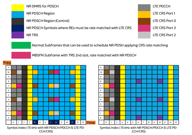

Yes , for DSS both SCS 15 KHZ an 30 KHZ can be used simultaneously but both required different MBSFN subframe. we know MBSFN subframe restricts CS RS to 1st two symbol in a subframe . so , suppose Subframe 1 and Subframe 2 is for MBSFN subframe ,then we can use SF#1 for SCS 30 and SF#2 for SC15 . for SCS 30 KHZ ,SSB transmission needed and 1 SSB need 4 consecutive symbol .
As said in MBSFN , only 1st two symbol will be used for Control signaling and 3rd symbol will be used for PDSCH-DMRS . so that we need to adjust SSB between remaining 11 symbol in that subframe .
if 1st ssb using Symbol 4,5,6,7th and 2nd SSB using 8,9,10,11th symbol then 11th Symbol will be overlapping with PDSCH -DMRS . so to avoid this collision with SSB with 11TH Symbol of PDSCH-DMRS , Symbol 12 used for PDSCH-DMRS and thsi is the only change required when SCS 30 KHZ used in DSS

Hi,
Please can you explain , how does the 11th symbol of 2nd SSB collides with PDSCH DMRS as it is mentioned PDSCH DMRS is contained within the 3rd symbol out of 14.
Perhaps I have missed something.
