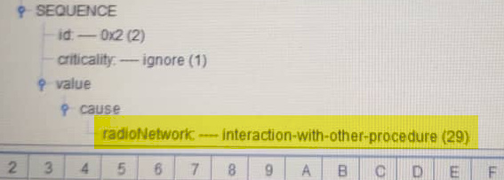

During S1 interface tracing we found S1AP INITIAL CONTEXT FAIL due to interaction with other procedure.
Can anyone help with solution?

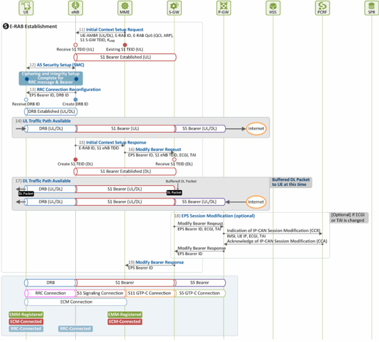

Please check the RRC connection message before the initial context message , to know what was the requested service.

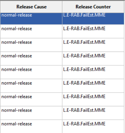

You need to identify the cause by corelating with UU traces. Mostly l.e-rab.failest.mme with cause ‘Normal Release’ are due to:
UE is in handover progress, source enb already sent HO preparation require to MME or other enb. During Handover, UE has service request of Csfb mo/mt, and csfb also initiated by mme sent s1ap context setup request. But enb found it conflict with HO procedure, so enb reply with context setup failure due to interaction.
Solution: it has one parameter to prefer csfb during ho. Enb will cancel handover, process csfb.
