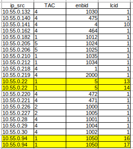

The following are the ips of the enodebs used:
The ones in yellow are βco-siteβ cells.

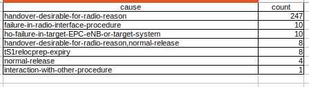

This is the distribution of the cause for the S1AP messages
majority of messages are related to handover(preparation, notification, cancelation, etc)
So for the moment I will recommend to doble check the definitions in the MME in terms of tac,enbid,lcid

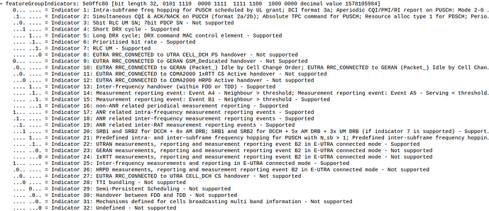

Now if nothing of this works, then take a look at the FGI in some of the messages and doble check in your mme configuration to see if a feature is supported or not.
FGI looks like this:
For example the UE used doesnt support handover from FDD to TDD, and there are many more features you can check in terms of compatibility.

Thanks for the thorough analysis. We donβt have to configure the EnodeB on the core (MME). They simply register with the MME. I reviewed the neighbor list several times. TAC, EnBID and PCI settings are all fine. I will see what EnodeB logs we can generate to figure out exactly why the MME returns HO Preparation failure. I could not find an exact reason in the tcap traces.
