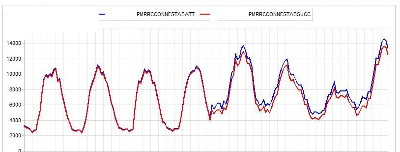

Hello Experts,
We face an strenght problem in our network.
Suddenly only L2100 in many cells degraded in RRC setup.
And pmrrcconnestabattreattmos increased.
Anyone has idea?
Vendor is Ericsson.

Ok, Thanks, we need DT analysis.
This issue happened for around 1000 cells simultenously.
We have three LTE layers, it happened only for L21.
L26 and L18 are fine.

pmRrcConnEstabAttReattMos: (description) --> The total number of RRC Connection Request attempts that are considered as re-attempts for Establishment cause Mobile Originating Signaling.
Thanks. This is what I thought as well… points to Msg4 reception issue.
