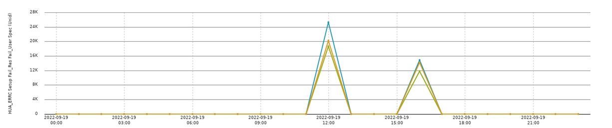

Any sugestions about L.RRC.SetupFail.ResFail.UserSpec failures in 4G Huawei?
Number of RRC connection setup failures because of limitation of UE number specifications.

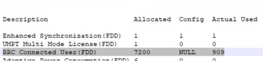

You have to increase the RRC user license.
I think that the problem isn’t licence, maybe it is Hardware.

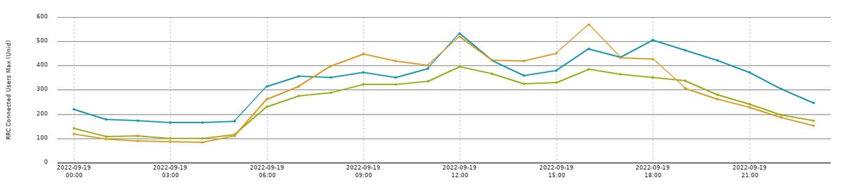

What is the trend of user max in BH?
What is the peak value?
Max user is around 1400 in BH.
1 line per sector.
Mmm I see. This is weird.
But at the same time you can see that the two peaks of failures correlate with the 2 peaks of user number.
This can be due to some hardware alarm or RRU issue in that time.
Seems Max UL Synchronized UEs Above BBP board specification.
It is recommended that the BBP board be replaced with a board with a higher processing capability.
But in this case the eNB will accept the user license number configured to exceed the board capability?
Seems the configuration of Max UL Sync UEs is less than the maximum RRC users which trying to camp on the node.
We can increase the Max UL Sync UEs if the BBP board can support, need to check the specification of existing board.
And if not supported, need to change the BBP board.
