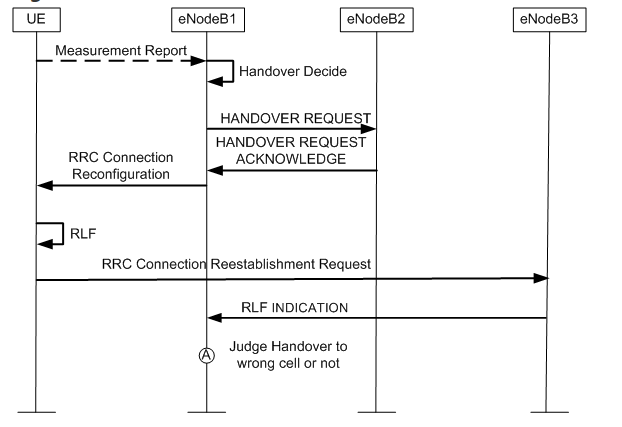

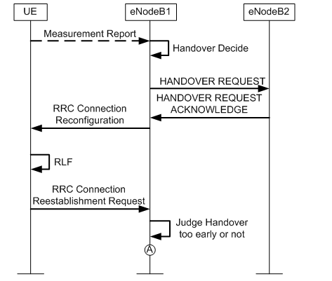

In the first picture, UE experienced a RLD during HO execution then UE send RRC con reestablishment to the source cell.
In the second picture, UE sent to another cell ( not source or target cell).
I dont see any case UE send to target cell RRC conn reestablishment.
