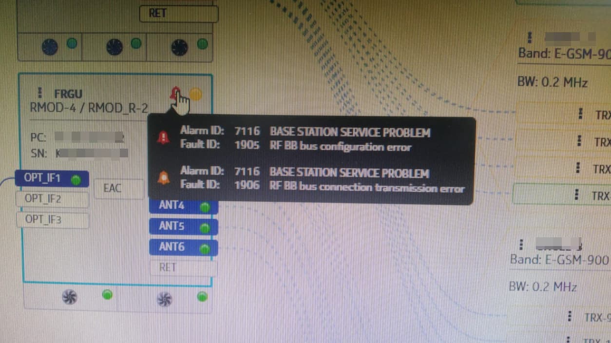

Hello Nokia Experts.
After upgrading 5 MHz to 10 MHz, these alarms are getting in sectors of a few sites.
There are two FBBC along with a FSMF in the sites.
How to resolve this?

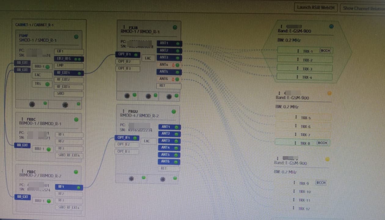

Can you show the connections view?
Change the connection.
Connect FRGU to port 1 of RF1 of FBBC 1.
When doing it on field, BO (Back Office / BSS guy) has to apply the change logically.
In the commissionning wizard.

Whether BB processing resources are taken from the FBBC to which it is directly connected or its shared among all cells?
Based on the connection you do, resources are allocated from that port to the next one.

You will have to see it this way after the port modification:
