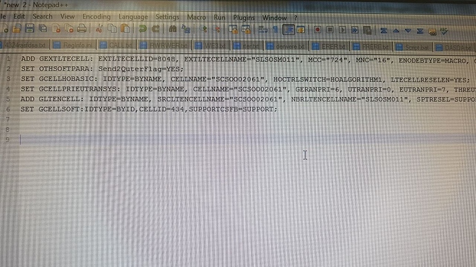

Hi Guys…My reselection 2G to 4G in Huawei does not work. Any Ideas?

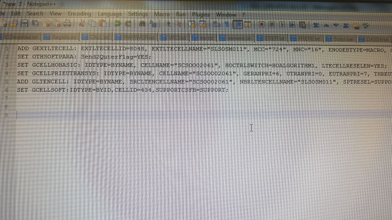

I applied similiar script in BSC

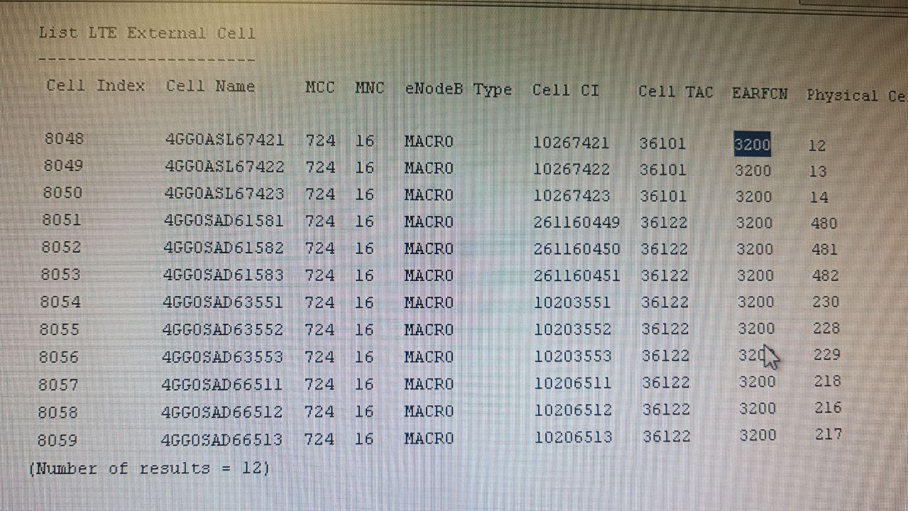

Is the EARFCN is correctly created in the GSM network ?
In the case of E/// it is necessary
yes it is created

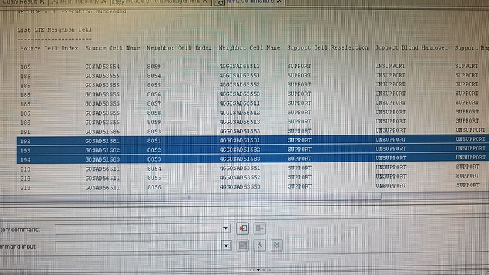

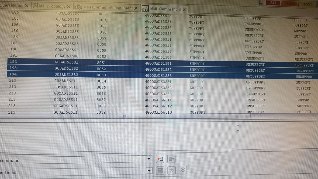

In 2g Lst GLTENCELL if LTE dummy neighbor defined properly
Yes.
GLTENCELL is configured!!

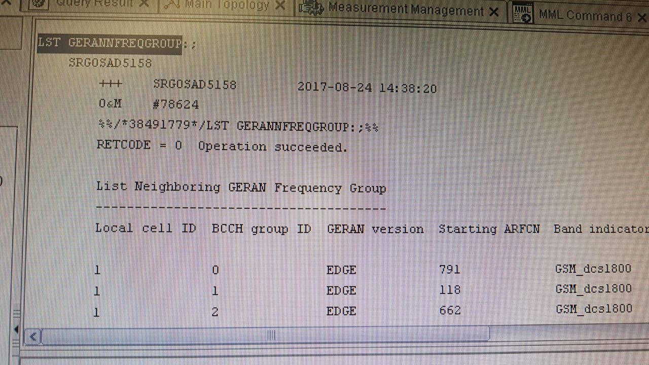

Lst GEranfreqgrouparfcn defined properly!!
Should by GSM arfcn defined
Not defined.
only GERANNFREQGROUP

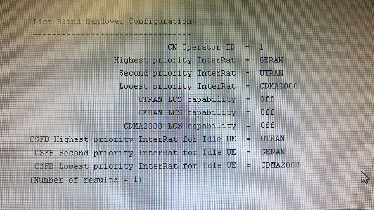

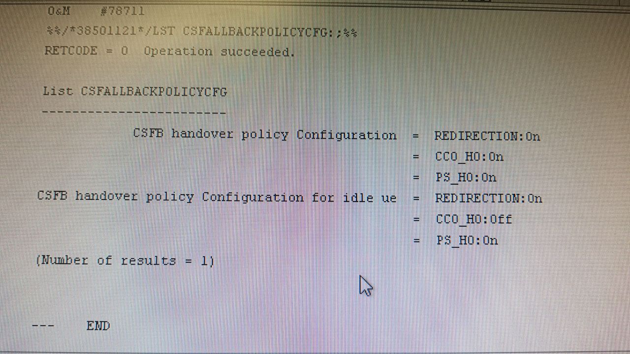

Also check lst csfallbackpolicycfg
Lst csfallbackblindhocfg

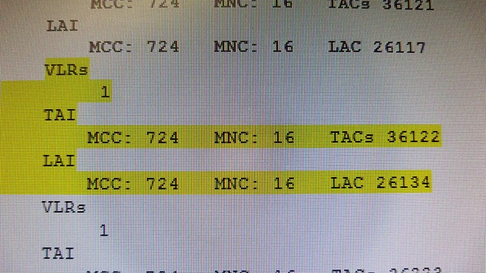

Lac/Tac mapping also at Mme end.
Lac/Tac mapping at Mme end
:+1:
Solved!!! Huawei set the LTE site in wrong MME

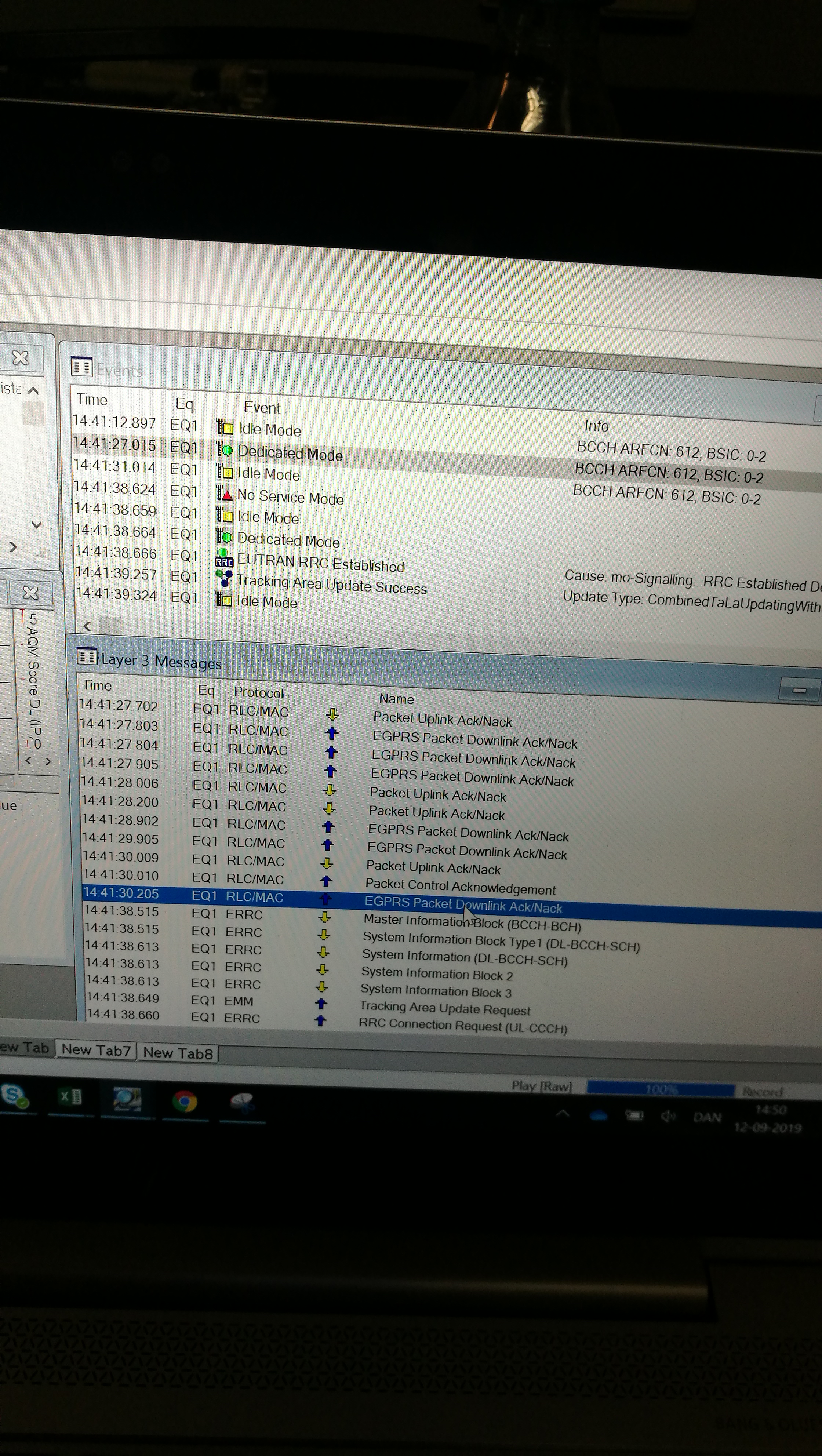

What about this case of 2G to 4G reselection? The UE is in idle mode in GSM at 14:41:31:014. I take out the UE from the Faraday cage (where there is only GSM) to outside where there is 4G. The UE goes to “No service mode” before going on 4G. What would be a reason for this?
Neighbor from BSC to LTE site was added. Reselection on GSM cell to LTE is enabled. System Information 2Quater is enabled.
