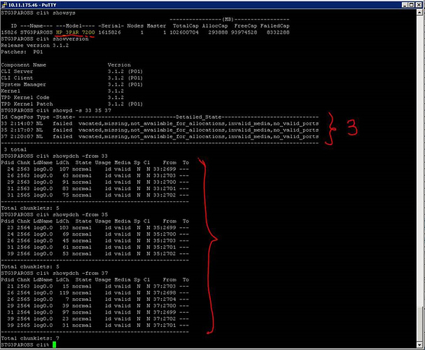

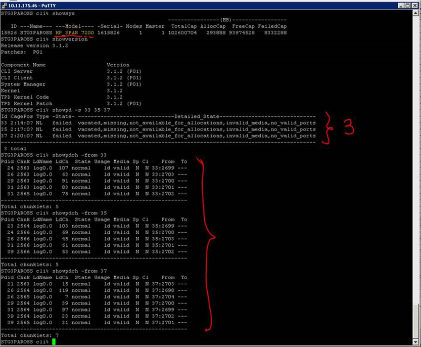

Scenario: 3PAR 7200 Storage solution (from HP) with 40 disks - 6 with failure.
This is old Hardware, no longer supported (warranty) by HP.
I was able to logically remove 3 failure disks, but I am still struggling to logically remove the remaining 3. I have already tried steps below, with no success and I need some guidance:
Summary:
3 disks are still stuck and without moving the “chunklets”, it will not be possible to dismiss the disks from the system forever and restore the system health. There is no way to replace the failed disks but only remove it from the system.
The disks have no volumes anymore so any data destructive command can be executed without fear. There are only data related to the Storage system/log-admin itself.
Below I have some commands to get actual status of the chunklets causing the problem:

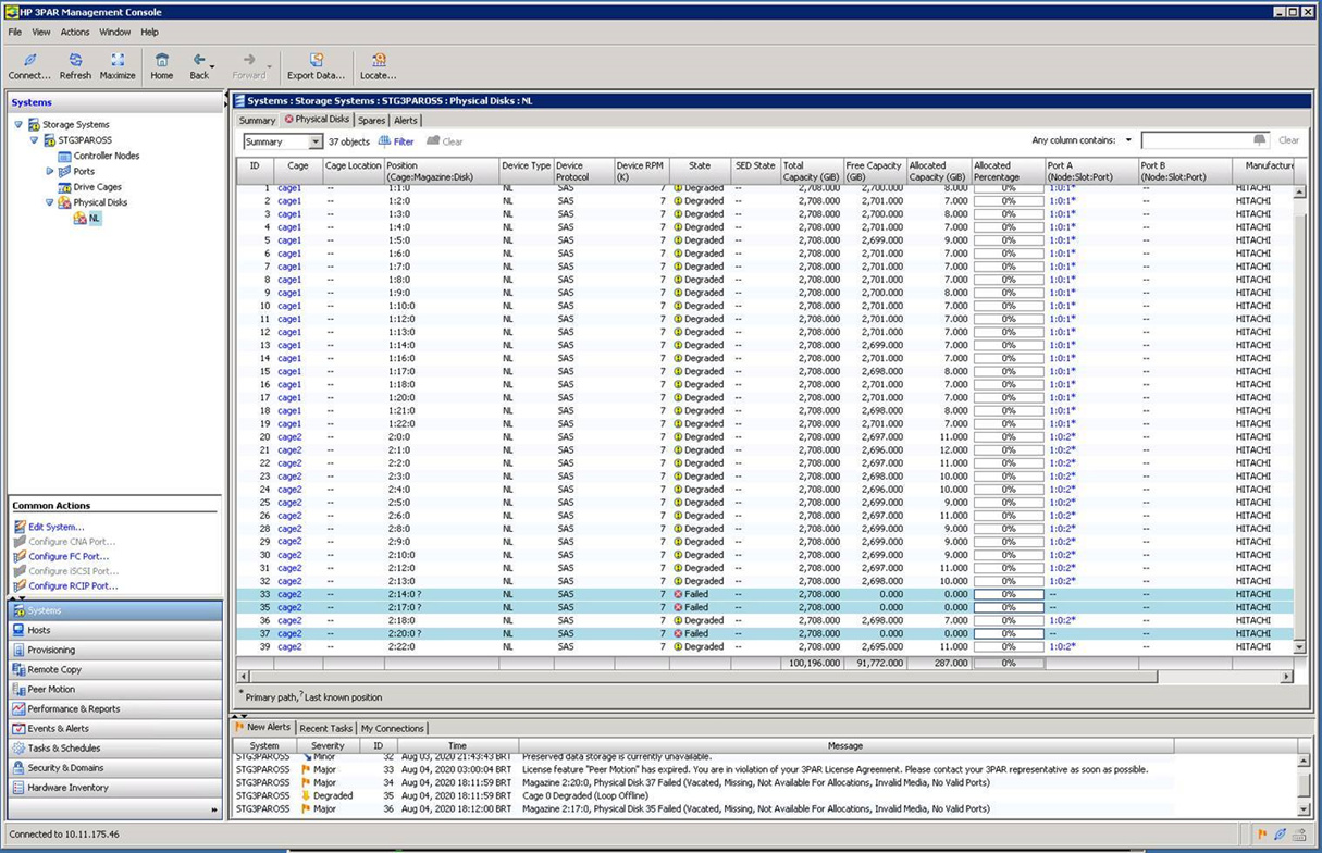

Management GUI but with only few capabilities, CLI terminal is the one I am using: You will notice the faulty disks 33, 35 and 37 (Cage2 positions 14, 17 and 20)

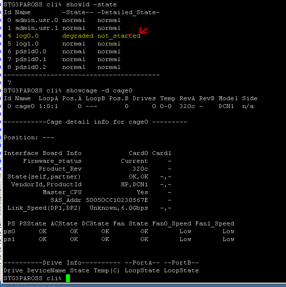

Checking the LD (Logical Disks) I found that the system LD for log0.0 has problems, that may be also related to the 3 disks failing to be unlinked from the storage:
Cage 0 : without disks

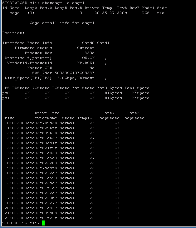

Cage 1 : OK with 20 disks OK

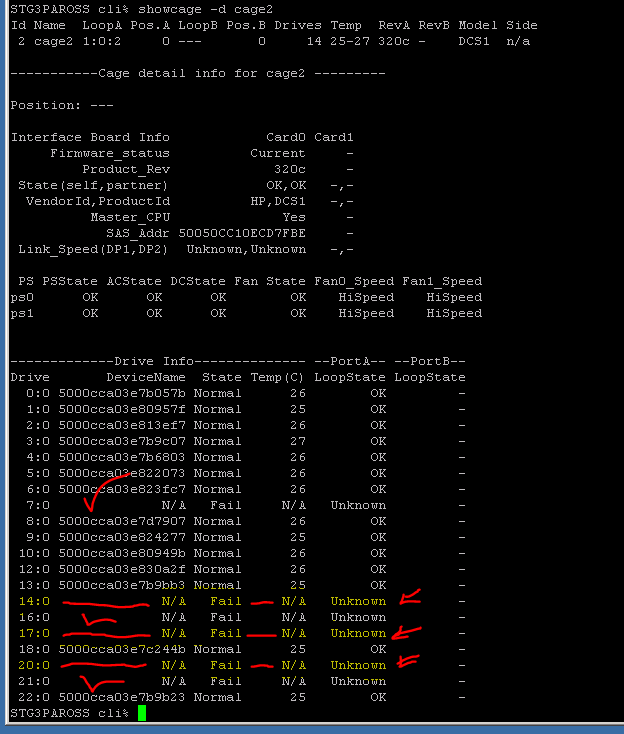

Cage 2 : OK with 20 disks – 03 were removed logically and 03 are stuck marked in yellow
Any help will be appreciated.
