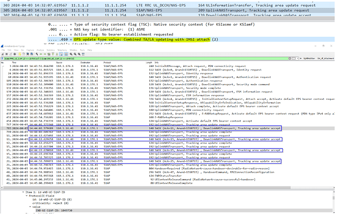

In our tests with General Mobile GM8, and Xiaomi Mi11 T model UEs, it was observed that there was constant TAU ​​(every 10 seconds) due to “Combined TA/LA updating with IMSI attach” cause. In MME, periodic TAU value is set as 1200. What do you think could be the reason for this problem? Thanks a lot.

Hi Sir, Many thanks for your quick reply. We are trying to perform basic acceptance tests such as simple IMSI detach and volte in the 4G environment, but TAU ​​constantly occurs in the system due to a situation we do not know why. If you want a more detailed log, I can share it. I thought if anyone had experience like this before it might help. It’s not due to T3412 timer, there should be sht problematic (may be at RAN side parameters.)

I checked the timer, it’s ok. TAC of both gNB’s are the same, so there is no TAC change. We will follow Ramin’s instructions about CA, then I will inform you again. Many thanks for your help.
