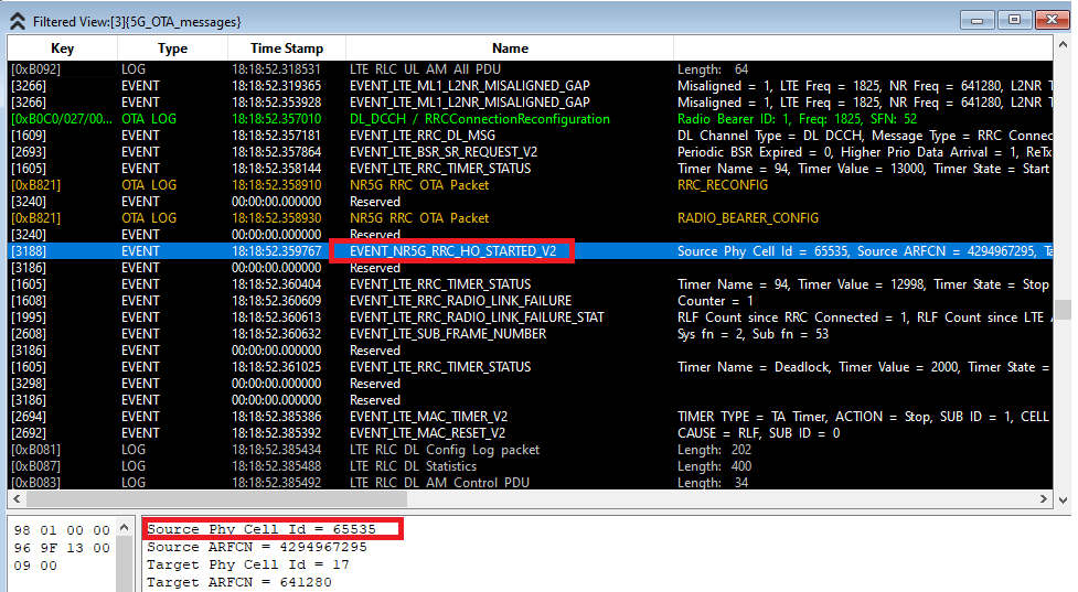

I have an NSA test case for bands b3 and n78 but it is giving me a reconfigurationFailure error. After RRC Connection reconfiguration the UE sends lot of preambles to LTE and fails to add the NR cell. I see from the UE log file that there is an event “EVENT_nr5G_RRC_HO_STARTED” (as marked in red) but the source phy cell ID has a different value from the actual LTE cell where the UE was registered. I do not have much practical experience so I would appreciate any help on this. Could you please advice me what are the possible reasons for this problem and where should I look at in order to solve it.

What is the first RRC message that UE sent after receiving RRC Reconfiguration message?
Is it RRC connection Re-establishment Request or SCG Failure Information? And what is the cause mentioned in it?
The message that UE sends is RRC connection re-establishment request, and the cause is reconfigurationFailure.

Can you share the content of the RRC_CONN_RECFG?
Sorry that I could not get back to you sooner. I had to temporary disable the setup for some urgent tasks but when I get back to it I will share all the info you need. Thanks for your time
