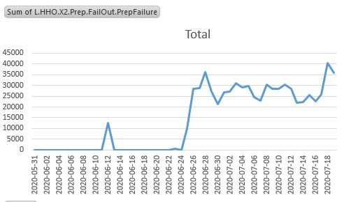

IHSR is degraded due to incoming handover preparation failures because of load-based admission failure in a cell (Top N fail with facing NBRs), what could be the reason for this? (OEM is Huawei)
X2 prep fail out also increased from same date:

Neighbors that try to do the preparation: its facing NBRs and both have increased failures as incoming from each other same date.

X2 faulty and handover going through S1 but coverage KPI of HOSR also get degraded.
So this means X2 Interface Fault can cause this issue as one of thee two cells involved has this alarm too as Ho admit switch was ON before too?
Yes, fault X2 will cause issue.
