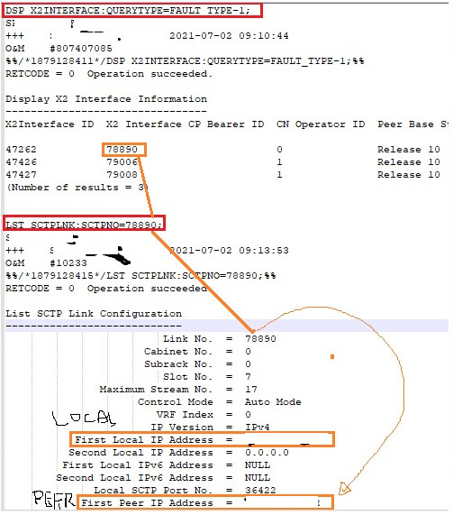

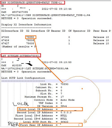

I suggest to solve the X2 alarm first. Try to do a PING between CP from Host to Peer.
Also, check it: DSP X2INTERFACE:QUERYTYPE=FAULT_TYPE-1;
Using the command you will check the “SCTP Link Failure” and can to check who is the Peer problem in “X2 Interface CP Bearer ID”.
After that, LST SCTPLNK:SCTPNO=X2 Interface CP Bearer ID;

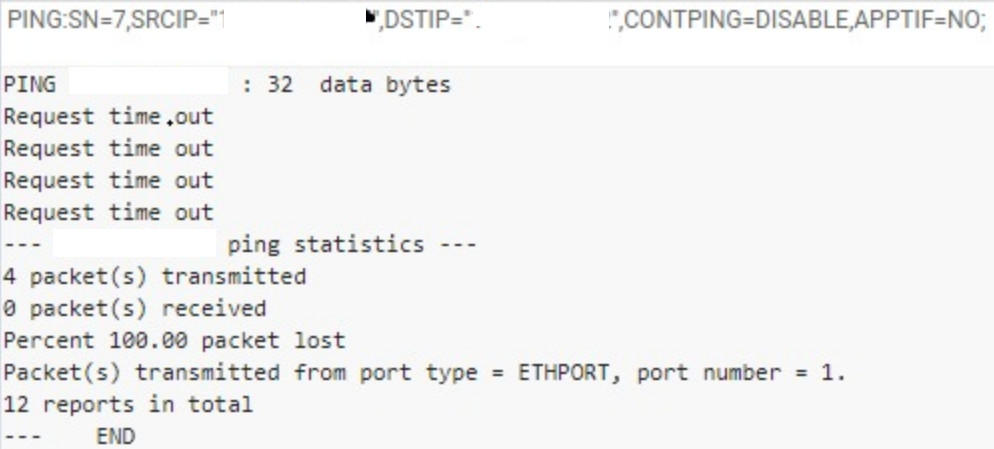

Using this you will have the both IPs (Local and Peer), so, try to do a PING.
Look my result: Problem between both.
