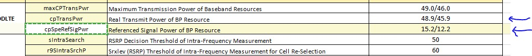

What is the difference between Real Transmit Power (cpTransPwr) vs. Reference Signal Power of BP Resource (and cpSpecRefSigPwr)?
The first value represents the total power for a specific BP, while the second indicates the power per RE (total power distributed across all REs of the BP).
