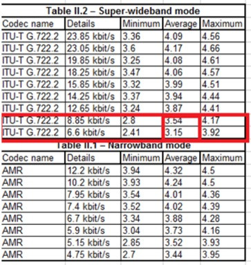

Here is a table with MOS score per rate:
Mos will improve if we use codec like wideband and so on.

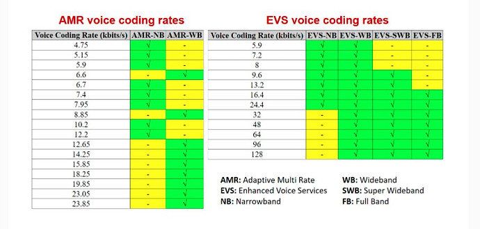

Updated tables for AMR and EVS voice coding rates:
