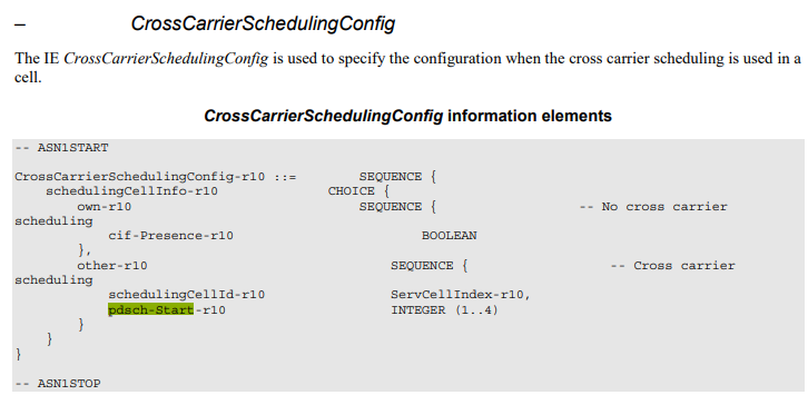

in Cross carrier scheduling for a component Carrier, the concerned CC uses different CC for PDCCH(for Both Common and UE Specific search space ) Then why do we need pdcch on Scell. We should have all Symbols available for PDSCH.

There is an exception if the cell is configured as a supplementry DL (without UL). In this case, there is no need to broadcast SI. However, it can still have PDCCH because cross carrier scheduling (which is a UE-based feature as well) may not be supported by all UEs which is the practical case nowadays
