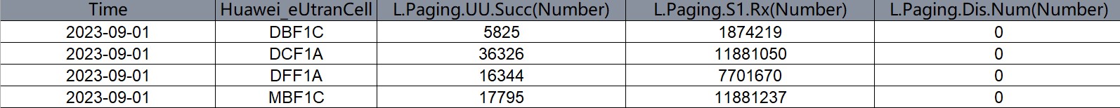

Paging SSR must be calculated at MME not eNB.
If calculated at eNB, KPI is very small.
MME level formula of discard: L.paging.dis.num/l.paging.s1.rx x 100.
UE to MME via eNB.
No. This discard is at cell paging channel.
MME sent 1 paging message to all eNB in TAC.
But only 1 eNB response.
SSR at MME = 100% but at eNB almost 0%.
But S1.rx are calculated from eNB to MME.
For cross verify you have n number of paging things to be sure.
For RAN side, I suggest 1 formula to estimate paging-ssr, at TAC level.
For eg: TAC-X has n enodeb, paging response of TAC-X = sum of paging response of n enodeb, while paging attempt per TAC-X = max paging attempt all enodeb received from MME.
Normally, paging attempt at all enodeb received from MME are equal, but due to some issue their may be different, such as transmission interupted, site sleeping, off.
So need to get max of all enb.
L.Paging.S1.Rx: Number of received paging messages over the S1 interface in a cell.
L.Paging.UU.Succ: Number of Successful Paging Responses from the UE in a cell.

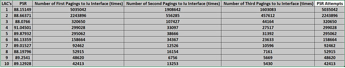

Hi Experts,
From the below paging counters analysis report of the top 10 worst PSR LACs from CS Core side Huawei vendor.
Is it this information enough to take next action to improve paging successful rate from MSS level?
Your sharing suggestion for next action to improve paging successful rate is highly appreciated.
I think you should balance the LAC size / load to have approximately same number of paging each.
Or maybe is time to split LACs.
The fact that you have so many third pagings with no answer it means you have lot of ping-pongs between LAcs or between technologies.
Many thanks!

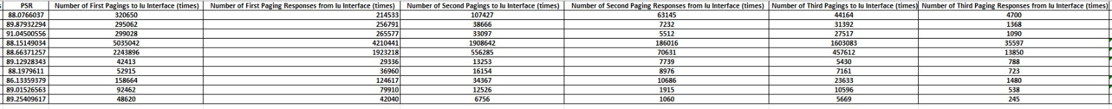

If I add the Paging Responses counter, will it add anything?
Could be. As well congestion on paging channel.
Go check with RAN engineers how many paging discards are due to congestion.

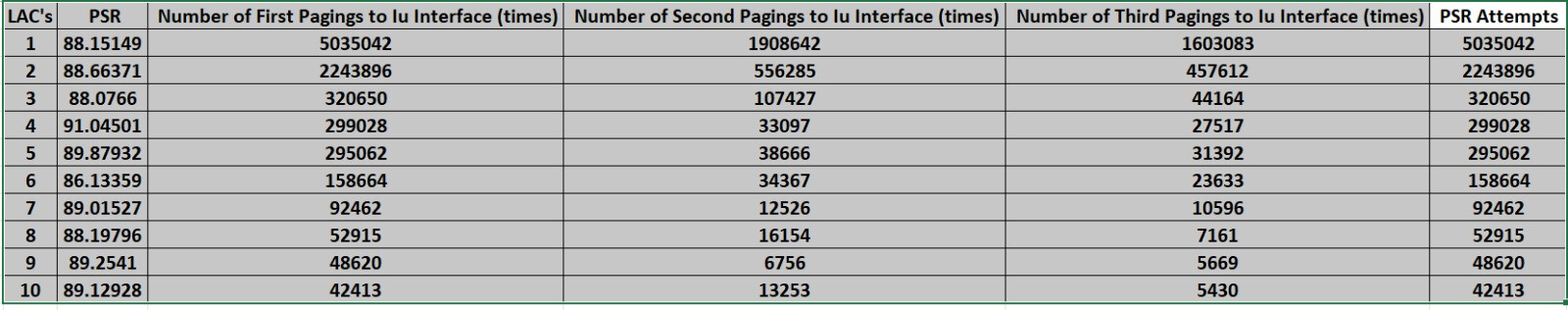

so from the below what i can calculate or what is the formula
