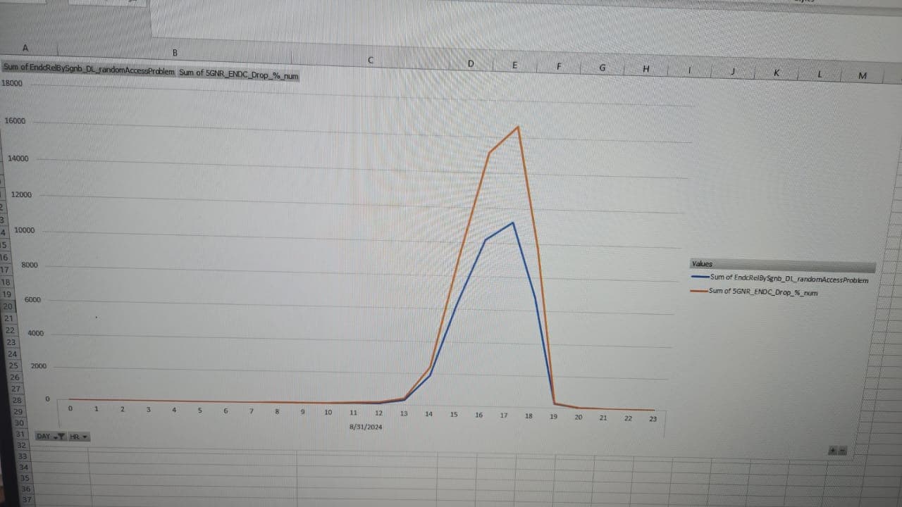

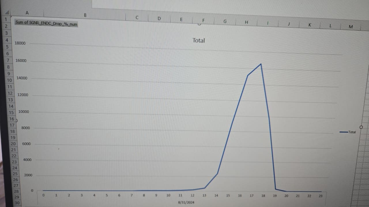

Let me show KPIs from my network and show you how when RACH fails ENDC drops increase:
Number of ENDC drops correlating with RACH failures!

However, Iād like to clarify that we are discussing the merging of NR RACH KPIs and ENDC KPIs. While I understand that NR RACH is mandatory for ENDC setup to succeed, in my case, the ENDC KPIs are good, but the NRDU KPIs are not.
Experts, I kindly request comments specifically on this context.

ENDC drops is ENDC abnormal release.
The other counter is a counter it self, not a formula
The vendor is Samsung by the wayā¦

My question is straightforward: in my network, the ENDC KPI seems fine, but the NR success rate is significantly low.
Hi I got your point in your case ENDC is established but this Ue measures neighbor NR cell and trying to change the and leg we call pscell change , here it has to undergo the rach process again where as your Menb remains same . During this rach process if you see scg fails there are 2 possibilities either NR pci conflict or the neighbor cell is too far and UL coverage is too bad so that gnb canāt rcv the Ue message. Correct me if am wrong, thanks ā¦
