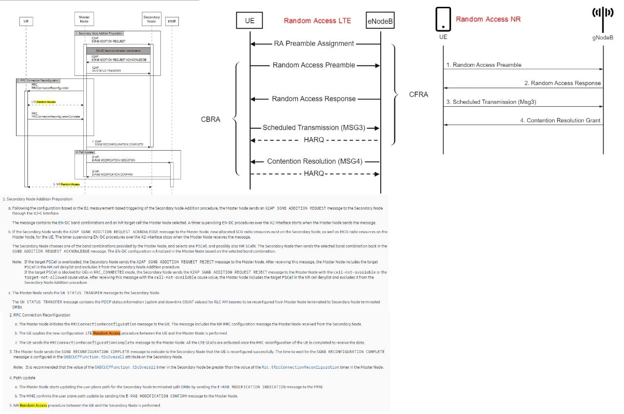

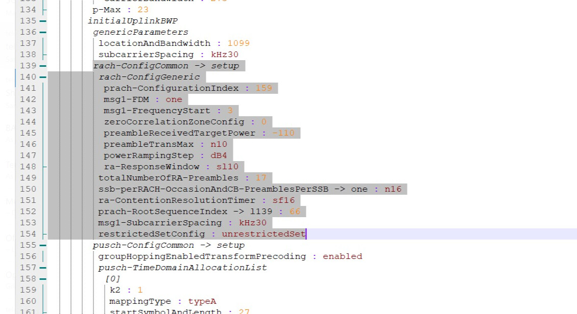

As per my understanding during ENDC procedure at RRC reconfiguration message eNodeB PRACH parameters.
I mean just like in this way, do you have NSA NR RACH flow?
If you have the call flow, please send.
With I.E. context containing related preambles, index etc.

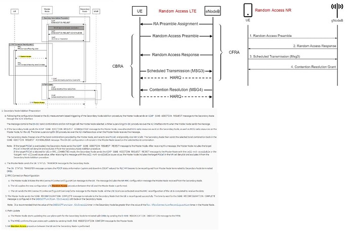

Here you have an example:
Pinaki_Mohapatra:
In NSA option 3x how will UE send RACH message, control part here is Master eNodeB…
So how in NSA UE can directly communicate with gNodeB without ENDC?
MeNB first send SgNBaddition request over X2, in the response of that message MeNB will get the SIB1 parameters (that contains RACH config) of gNB that will be further transmitted in RRCReconfig.
Yes!
Then after complete flow NR RACH NSA.
Maybe this will help you illustrate what you are looking for in relation to the END-DC RA Process:
No this is ENDC.
Number 5 steps RACH part for ENDC.

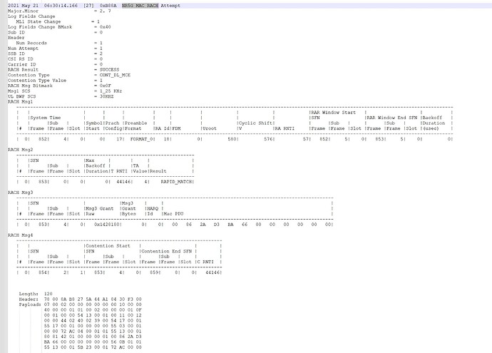

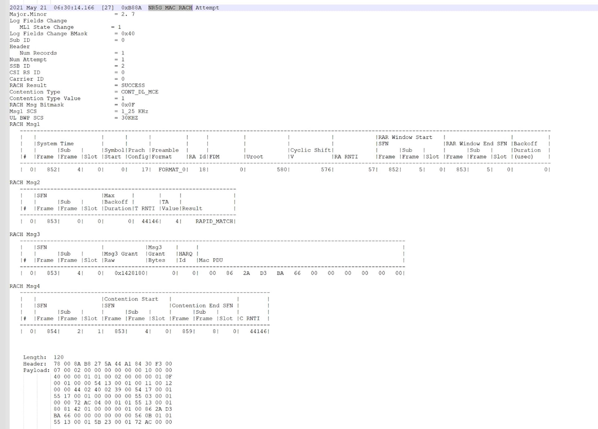

Here is a RACH 5G from a real UE log QUalcomm chipset:
