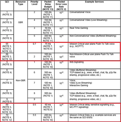

QCI5 is IMS - is normal to be there.
QCI6 is Internet Bearer - it is also normal to be there.
In every VoLTE call you will find QCI1, QCI5 and another QCI (6,7,8 or 9) for Internet.
As @RFSpecialist said, generally Qci5 is used for VoLTE signaling.
It’s like that you Qci6 is default bearer.
However I have seen error in some network where SIP signaling creeps onto default bearer.
As long as all your SIP messages have Qci5 marking, you are good.

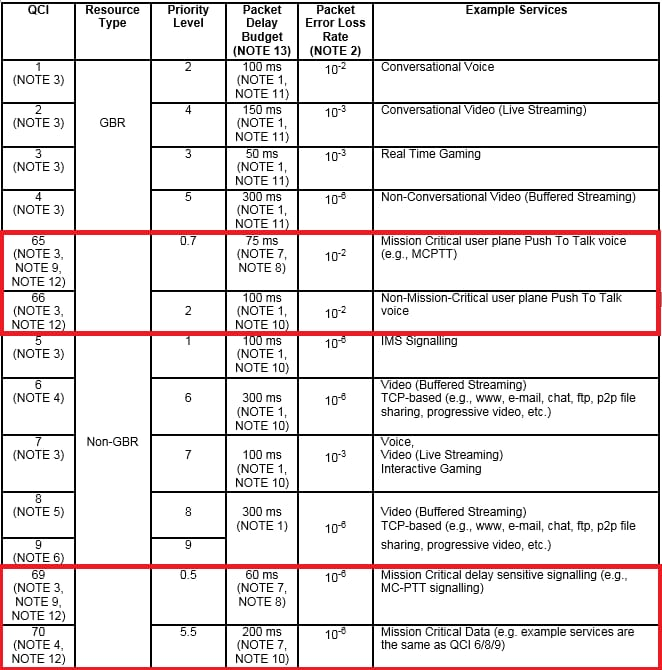

Like said above, before and all we know:
QCI 1 and QCI 5 for VoLTE
QCI 6, 7, 8, 9 for Internet

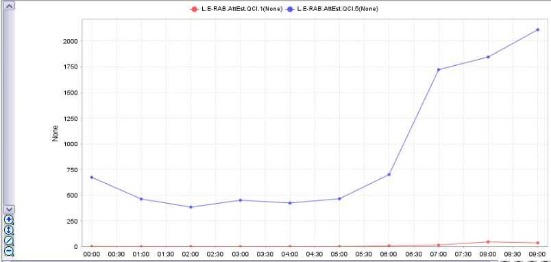

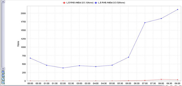

I’m finding QCI-5 is > QCI-1 ? It´s normal?
To SRVCC should I adjust the HO parameters (like A2 and B1 event) based on QCI-1 or QCI-5?

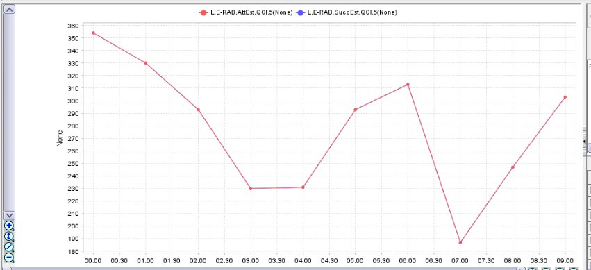

Abnormal. How is qci5 setup success rate?
It is OK.
