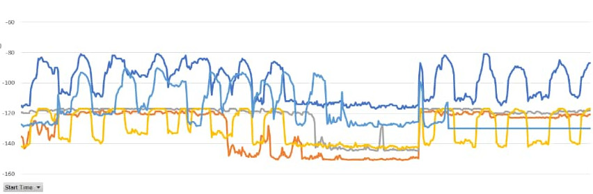

It’s graph takes the shape of pusch interference

In your chart I see values like -120 dBm max for PUSCH.
It is not too bad, I think.
