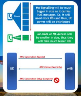

Do you have PRB blanking?
Are there any specific counters being triggered?
Otherwise, you can refer to the link below for an analysis of RRC setup success rate (%).
What is that?
There’s no counter for RRC connection complete. The eNodeB times out after 3 seconds following the RRC connection setup message sent to the UE.

In this scenario, you leave certain RBs blank within the bandwidth due to overlap or similar issues. You’ll need to adjust all other cell parameters to account for a custom start and end of the band.
