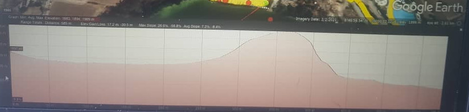

Rsrp is < -105 dBm. The site is 600 meter far from area, and Max RS Power is 15.2.
Any Parameter to improve the coverage?

Azimuth shift to direction of area might help…
Nah, he has that hill blocking Line of sight…not much he can do.
Atleast try it’s tough.
Blocked by Mountain

With limited available information, the solution seems to be uptilt your etilt by 2*, however, it dep ends on your tower + antenna height, whether it works or not.
The only negative consequences may be overshooting in some other parts of antenna serving area. Check all aspects of performance after tuning.
