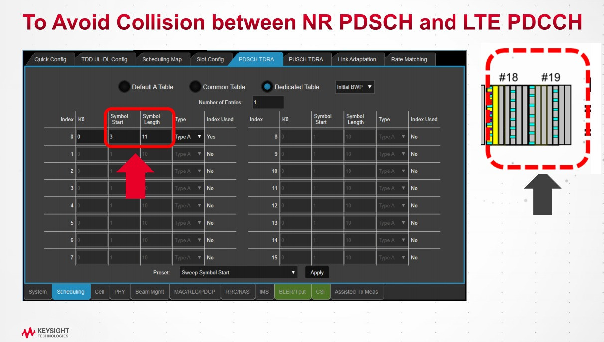

There’s a good DSS that explains how to avoid colission between NR PDSCH and LTE PDCCH:
5G NR Dynamic Spectrum Sharing Drivers & Test Implications - Project Manager / Keysight Technologies - Alex Liang
