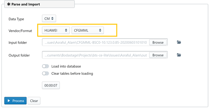

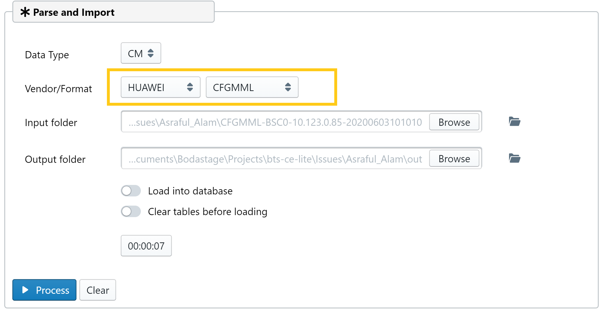

From the logs you appear to be using the wrong format . You should use CFGMML.
See the screenshot below for the options to select.

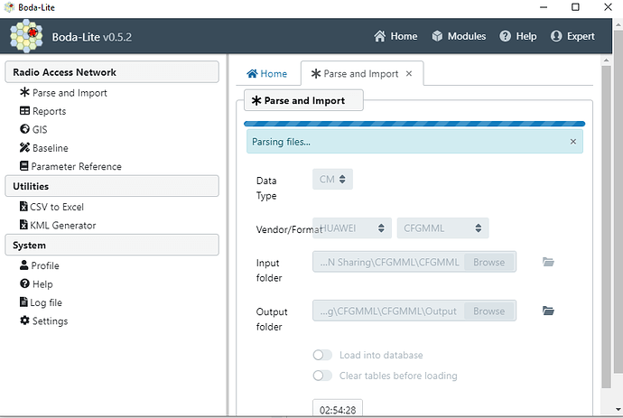

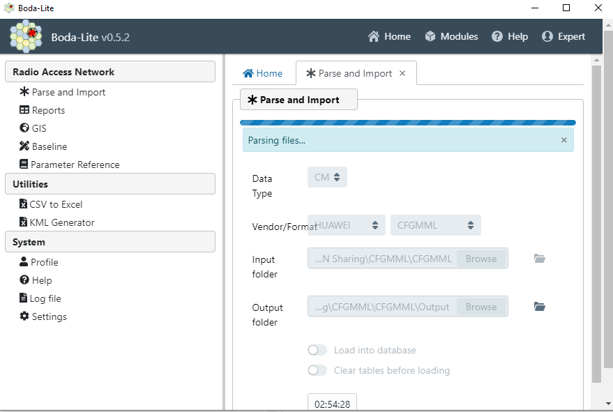

Thank you for your replay. I tried your several times but it is not generating any report and it is never ending process.
yes i agreed, i tried that tool and same happened with me. It took infinite time and it never ends. Can any one support on this?

Same problem here, I could never use it. it always appears the parsing file message and never finished.
I thought it was my older computer but problem continues in a different one.
