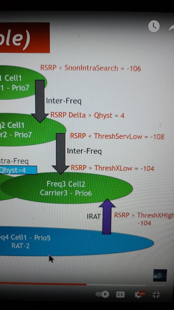

I am wondering how to obtain SnonIntraSearch like in the image:
Is this RSRP the measured of the UE?
For Huawei vendor:
MOD CELLRESEL:LOCALCELLID=11,SNONINTRASEARCHCFGIND=CFG,SNONINTRASEARCH=3;
Snonintrasearch (dBm)= QrxlevMin * 2 (CELLSEL) + 2 * Snonintrasearch.
For eg, if QrxlevMin in CELLSEL MO is -64, and Snonintrasearch = 8, then Snonintrasearch = -64 * 2 + 2 * 8 = -112 dBm
Yes, correct.
